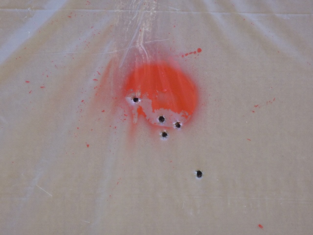

Finally got a nice enough day to test shoot my Colt New Frontier 45 since I shortened the barrel. This is at about 15 yds. Five shots with .454 size Hornady lead bullets and Trail Boss. Just a moderate easy load and not trying to get maximum power just a nice shooting load. I will refine this again but for a first test I am happy. I pulled that last one down so it could have been a tighter group but with the way this old body shakes this is not too bad. Chris S
Nice work and nice results. Looks well balanced.
Good work on the Colt

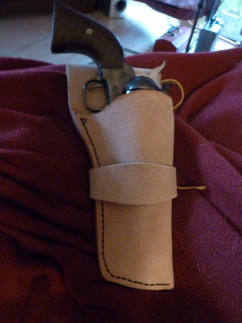

Got bored sitting around so I scrounged up some leather and sewed up a holster for the new short barrel. Serious holster makers need not fear, this is strictly amateur work. Chris S
Come on, Chris,
Why call it amatuer work? When our passion is guns, we learn how to do many things. And, even though I can afford the best stuff now, I am still thrilled to make things myself.
